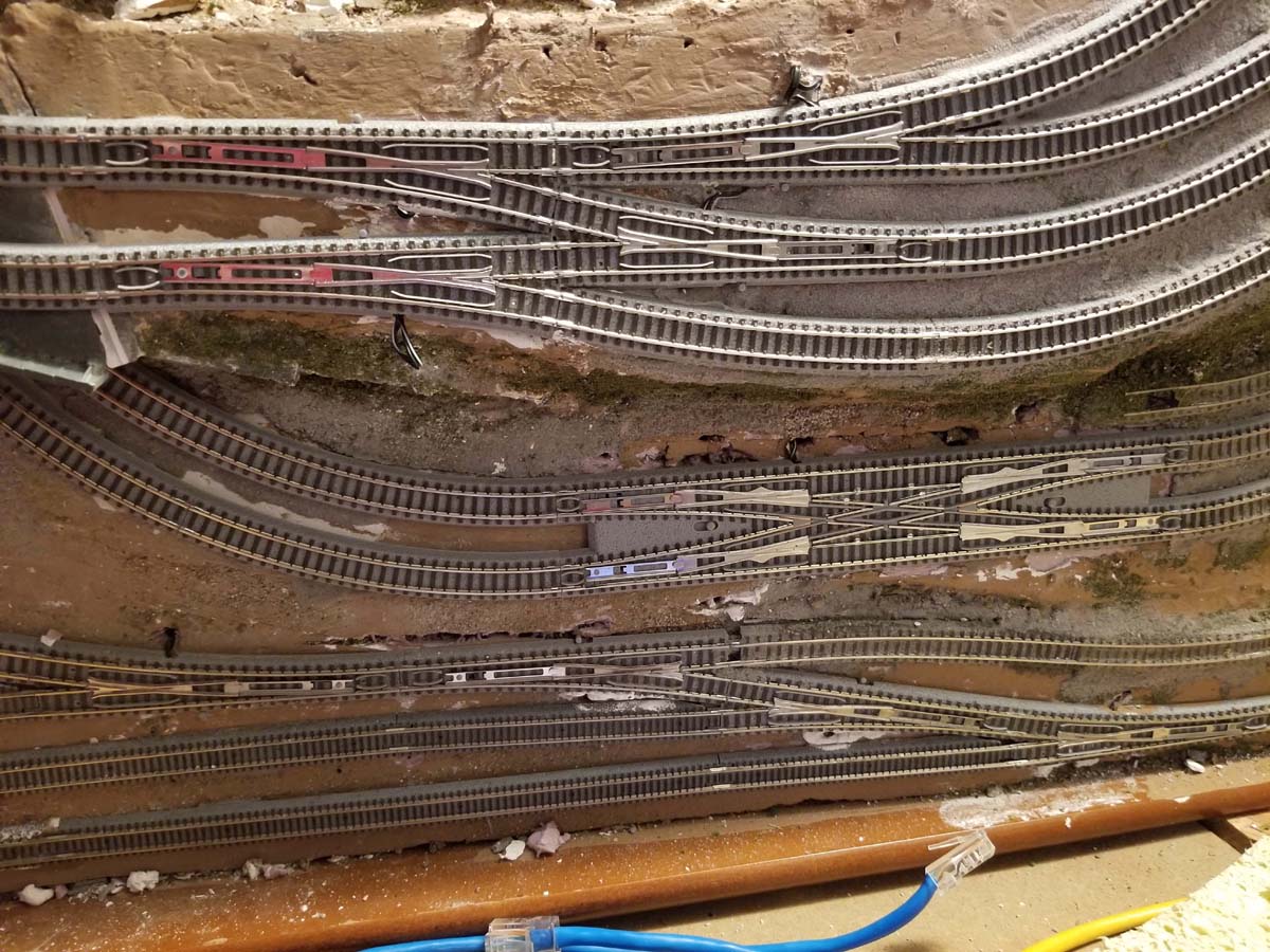

Here are views of the two Rokuhan Double Crossovers. They perform well in testing.
File comment: Had to tear out my road crossing to fit this one in.
Now to blend them back into the scenery.
File comment: This one gives me more flexibility in operations on the main.
I've found a few more turnouts that need cleaning due to scenery glue leaching into the mechanisms. Time to fix is now before putting the drawer back in the table.

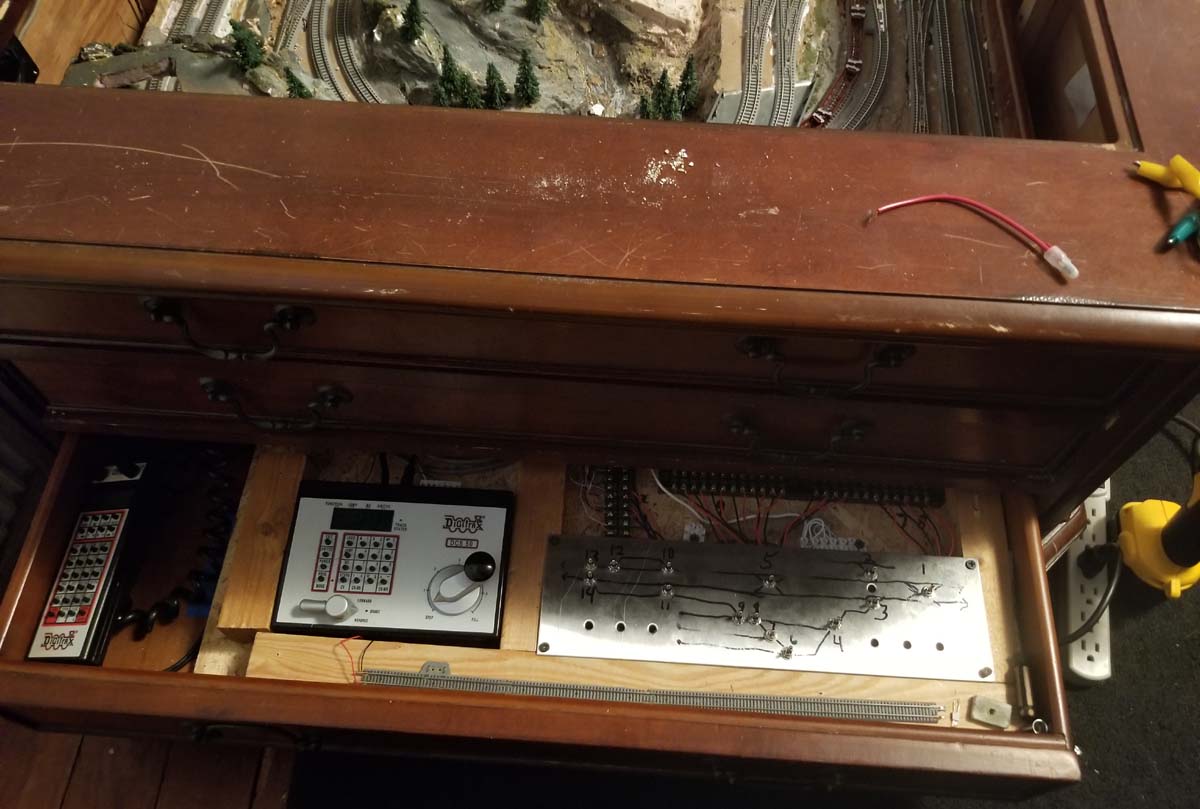

The throttle(s) will be accessible by sliding out the bottom drawer. Wiring and switches are on one side and car storage on the other.
File comment: temp panel in place
Still not happy with turnout consistency. More work to do before finishing up.

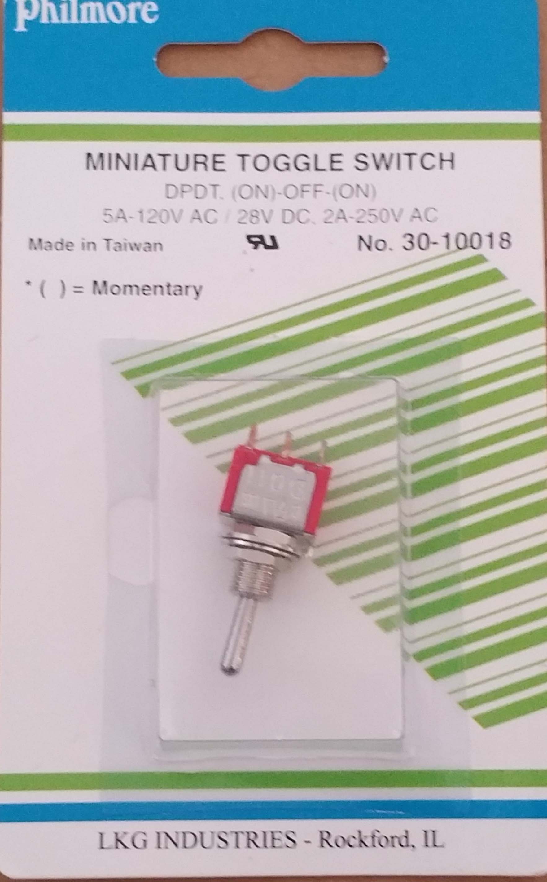

These are the switches I am using for turnout control. DPDT Center off momentary. Make sure they are momentary as the turnouts will fry if you keep power on on them beyond a sec.

One side of the bottom drawer houses the controls:
File comment: Added temp overlay to panel
Don't worry; we will dress it up later. I still need to sync the turnouts with the switches. Some have polarity reversed.
