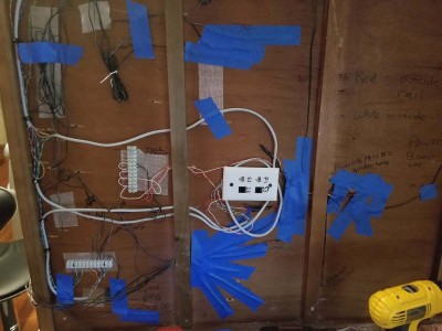

PostPosted: Wed Feb 19, 2020 2:09 pm

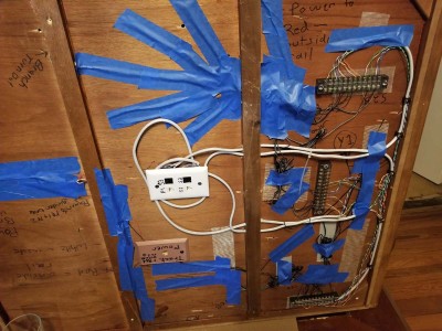

Time to finish this wiring once and for all. I hate the little terminal blocks.
I will be running the switch machine wires thru the 4 socket wall plate in the middle. The plate is just under flush with the bottom so the drawer can be removed by unplugging the network cables. Dont worry, i will tidy up the cables. I'm going to make some panels to cover and protect the loose wires.
File comment: old terminal blocks

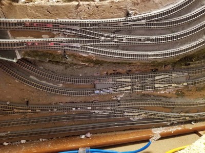

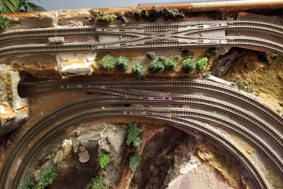

Here are views of the two Rokuhan Double Crossovers. They perform well in testing.
File comment: Had to tear out my road crossing to fit this one in.
Now to blend them back into the scenery.
File comment: This one gives me more flexibility in operations on the main.

PostPosted: Tue Mar 03, 2020 3:11 pm
I found the new terminal blocks were much easier to access. Switch machine wiring is connected via RJ45 Ethernet connectors to allow drawer removal.
File comment: New terminal blocks

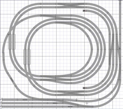

The revised trackplan:

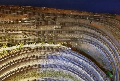

Rokuhan turnouts and crossovers.
Yard entrance and loading spur. Might have to put in a double crossover here.
New double crossover (Crawford West on upper level).
Crawford East and double crossover

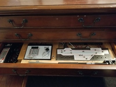

PostPosted: Tue Mar 17, 2020 1:08 pm

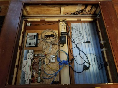

The throttle(s) will be accessible by sliding out the bottom drawer. Wiring and switches are on one side and car storage on the other.
File comment: temp panel in place
Still not happy with turnout consistency. More work to do before finishing up.

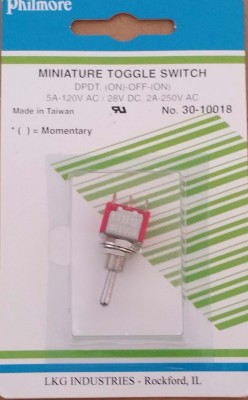

These are the switches I am using for turnout control. DPDT Center off momentary. Make sure they are momentary as the turnouts will fry if you keep power on on them beyond a sec.
File comment: DPDT CO Mom
PostPosted: Fri Apr 03, 2020 11:55 pm
Almost ready for prime time:
File comment: New Plan
I modified the plan to include a third double crossover at the yard entrance.

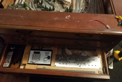

One side of the bottom drawer houses the controls:
File comment: Added temp overlay to panel
Don't worry; we will dress it up later. I still need to sync the turnouts with the switches. Some have polarity reversed.

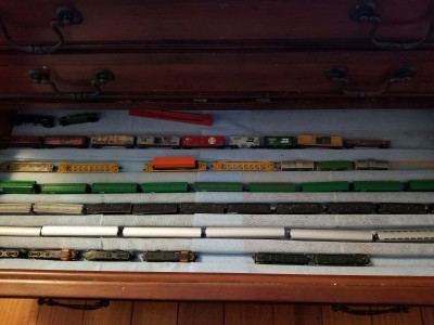

The other is for rolling stock storage. I need to order some felt, but these hand towels will work for now.

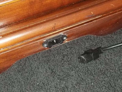

I added a power socket and use a PC style cable to power everything.

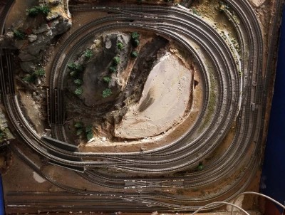

PostPosted: Sat Dec 19, 2020 9:40 pm
A more recent look at the layout. Note the compressed Aristocraft REA warehouse in the background.
